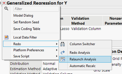

You most likely get most of the answers from JMP Help page https://www.jmp.com/support/help/en/18.1/#page/jmp/launch-the-generalized-regression-personality.sht... .
You can also run your command and from the resulting report go to red triangle and go to Relaunch Analysis to see how you fill in the platform (Fit Model in this case with Generalized Regression personality and LogNormal Distribution)
