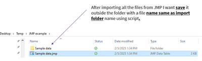

Save JMP file generated using import function to specific location with specific name.
I am importing multiple file from using import function. I want to save it automatically outside the folder and with same name.

I assume you want to save files found from Sample Data folder into single JMP table named Sample Data.jmp which is on the same level as the folder.

Re: Save JMP file generated using import function to specific location with specific name.
Thanks for the explanation. I worked fine.
I was able to get file name but was strugalling with saving it.
