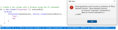

I am generating new column based on a user input and need to move
I am generating new column based on a user input and need to move using script. Can anyone help to fix my script
dt << New Column("Suspected "|| selectedCol,
	Formula(
		If(Contains(myValueList, char(as column(selectedCol))),
			"Yes",
			"No"
Data Table( dt ) << Move Selected Columns( as column("Suspected "|| selectedCol), after( as column(selectedCol) ) );

I'm able to get it to work by enclosing As Column() in a Name Expr() and putting it in a list.
dt << Move Selected Columns(
	{Name Expr( As Column( "Suspected " || selectedCol ) )},
	After( As Column( selectedCol ) )

Here is how I got it to work
dt << New Column( "Suspected " || selectedCol,
	Character,
	Formula(
		If( Contains( myValueList, Char( As Column( selectedCol ) ) ),
			"Yes",
			"No"
Eval(
	Parse(
		"dt << Move Selected Columns(:Suspected " || selectedCol || ", after( :" ||
		selectedCol || ") );"

I would strongly suggest adding expression evaluation to your column to avoid possible issues (compare how my formula vs your formula looks like). You can also get reference to the created column and use that with <<Move Selected Column
Names Default To Here(1);
selectedCol = "age";
myValueList = {"12", "15"};
newcol = Eval(EvalExpr(
	dt << New Column("Suspected "|| selectedCol, Character, Nominal, Formula(
		If(Contains(Expr(myValueList), Char(Expr(NameExpr(As column(dt, selectedCol))))),
			"Yes",
			"No"
	newcol, After(Eval(selectedCol))
-Jarmo

This way works, too, with only the string in a list, but the After() has to have As Column().
	{"Suspected " || selectedCol},
