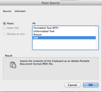

If I am on a Mac JMP 11.2 and I use the selection tool and paste into Word I choose Paste Special and get the following dialog where I choose pdf to get good results.

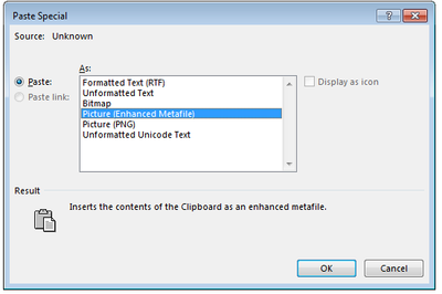

In Windows with JMP 11.2 I use the selection tool and the Paste Special and get the following choices where I select Enhanced Metafile
