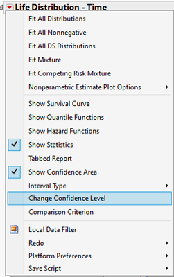

To find the number, you need to know where to specify the desired confidence level; see this screenshot:
