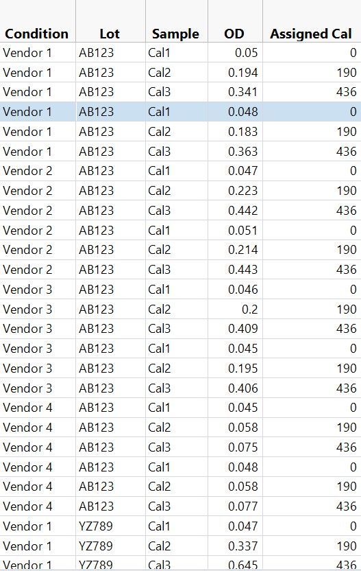

I am trying to write a script to automate the creation of a Bivariate graph. Below is an example of my data:

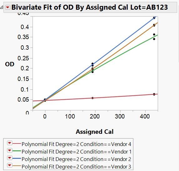

I created the Bivariate output I wanted using the point-and-click method:
  • assigning column OD to the Y response, column Assigned Cal for the X response, and column Lot for the By role
  • right-click on the red triangle, click Group By, selecting column Condition
  • right-click on the red triangle, click Fit Special, selecting 2 Quadratic from the dropdown and unchecking Centered Polynomial
and the resulting graph is what I want:

Re: Creating a flexible Bivariate script with n Conditions (example given)
You need to use the << Group By( column ) message with the Bivariate object before fitting the chosen model:
platform = Data Table (dt3) <<
Bivariate(
	Y( :OD ),
	X( :"Assigned Cal"n ),
	By( :Lot )
platform << Group By( :Condition );
platform << Fit Special(
	Degree( 2 ),
	Centered Polynomial( 0 )

jbolinger
Level II
I figured the solution might be as simple as this, but I just lacked experience with how things like Group By() and Fit Special() work as direct messages. This solved my problem, thanks!
