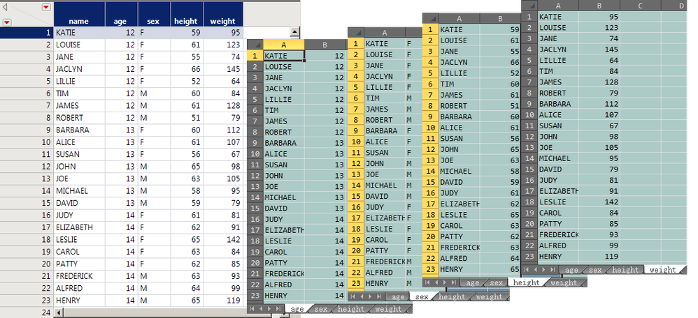

I would like to ask JMP community to help me out on a custom way to export JMP table to excel.

My requirements differ from the code of the JMP sample.
I opened only one JMP file and divided "age, sex, height and weight" in the “Big class" into 4 different tables with name respectively, and saved them into 4 different tables in the same excel workbook.The four tables in this excel workbook are named "age," "sex," "height," and "weight."

I understand. First, divide "Big class.jmp "file into 4 JMP files with JSL as required, and then run the above code to generate an excel file of 4 tables.
Thank Jim!

I understand the full JSL is like this.
But can't it ——{"age","sex","height","weight"}——be generated automatically by code?This enables automation for different files.
Thanks!
