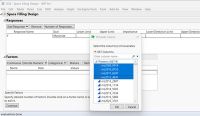

When creating your Space-Filling Design from the covariate table you have opened, click on the red triangle and choose "Load Design". This will open a new window where you can select your covariates :

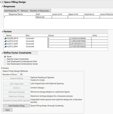

Once your covariates selected, you'll have the possibility to realize a Fast Flexible Space-Filling design with the specified covariates :
