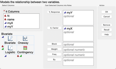

Can you explain how it's not working for you? The Group By option will cause the Fit commands to perform one fit for each level of the grouping variable.
I used your data table and and ran Fit Y by X with myX and myY respectively.
Then I chose the "Group By..." option from the Bivariate menu and used Name as the Grouping variable.

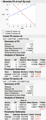

Then fit a line and got this result:
