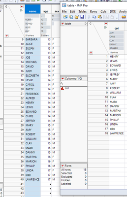

Hello!
Assumption: The original data is obtained in the clipboard with consecutive empty lines at the end, and the rows that are not empty are not copied.
How to use the RE to intercept the content starting after the line containing the specified content and ending on the empty line.Copy to the new table.
For example: "Big Class.JMP"
And it says "ALFRED"
It get my new table.

In this simple case there is no need for regex and you can just get index from the list. If more complicated comparison is needed it should be fairly easy to build a loop to go through the list
Names Default To Here(1);
dt << Add Rows(5, at end);
dt << Select columns("name");
Main Menu("Copy With Column Names", dt << Get Window Title);
clipb = Get Clipboard();
txt = Trim Whitespace(clipb);
l_all = Words(txt, "\!N");
break_str = "HENRY";
l_interested = Substr(l_all, Contains(l_all, break_str));
dt_new = New Table("table",
	Add Rows(N Items(l_interested)),
	New Column("col", Character, Nominal, Values(l_interested));
-Jarmo

  • Note: The data I'm actually working with is from the clipboard.
Thanks!
