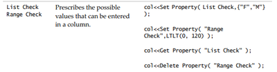

However, I am trying to also use Range Check within set property following the scripting guide (for JMP 16)
Column( dt, myCol ) << set property("Spec Limits", {LSL( myLSL), USL( myUSL )}, "Range Check", LTLT (myLSL2, myUSL2) ));
where myLSL/myUSL & myLSL2/myUSL2 are supplied from above. This is not working (in JMP 16.2). Where am I going wrong?

Your script almost works.  You'd just need to split in into two messages, because <<Set Property only handles one property at a time.  Your syntax and @hogi's syntax for adding a Range Check are both correct.
Names Default to Here( 1 );
lsl1 = 13;
usl1 = 110;
lsl2 = 5;
usl2 = 117;
:weight << Set Property( "Spec Limit", {LSL( lsl1 ), USL( usl1 )} ) << Set Property( "Range Check", LTLT( lsl2, usl2 ) );

The syntax for Range check is slightly different:
:height << set property("Spec Limits", {LSL( 10), USL( 20 )} ) << Range Check( LELE( 0, 100 ) );
