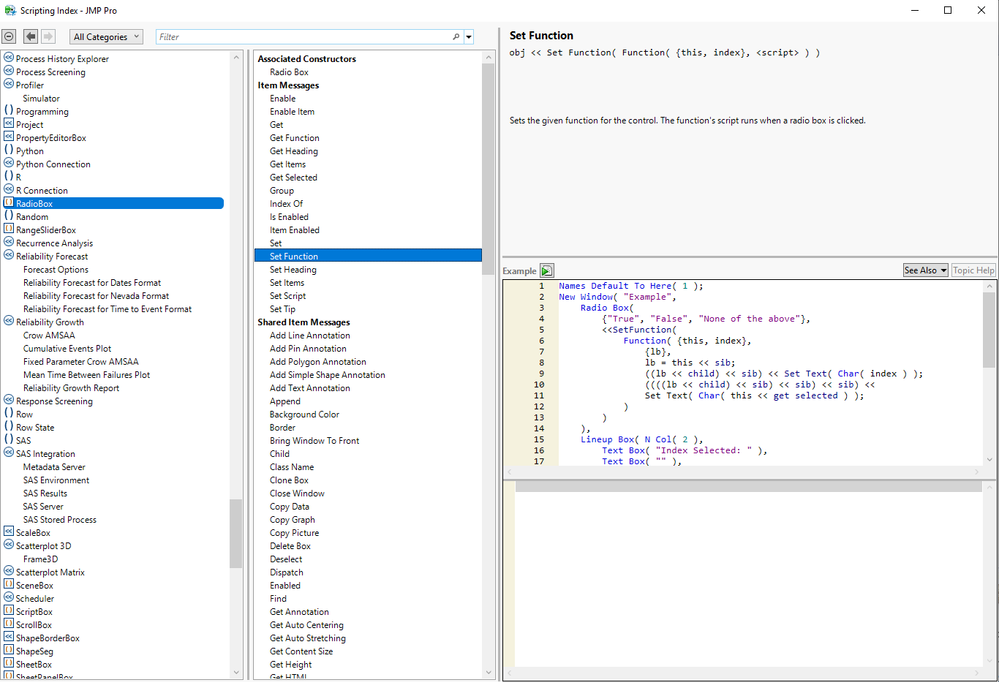

You mention that you are self teaching JSL.  Given that, I suggest you take the time to read the Scripting Guide
     Help==>Books==>Scripting Guide
and that you become very familiar with the Scripting Index.  In the index, you will find all of the messages, etc. that can be sent to the functions and objects, and will give you examples of each.  Below is the example that is referenced in the section of the guide for Radio Button(), using a Set Function() for processing
Jim
