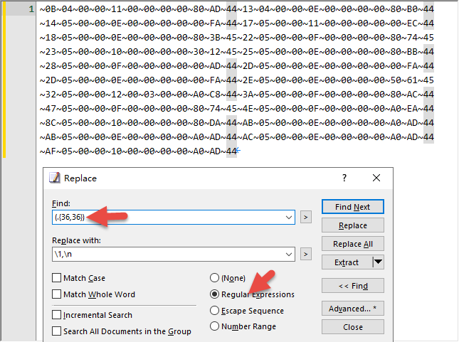

Re: How to use JSL to split a contiguous binary file into segments in bytes?
  • For example, regular substitution with EmEditor is easy to implement2023-02-12_21-59-57.png
