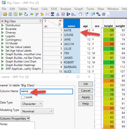

How to use JSL to set the color gradient of a column in text format by the value of a numeric column?
For example, the name column of Big Class.jmp automatically sets the color gradient of the name based on the value of the height column
It is required to be done in script.
Thanks!

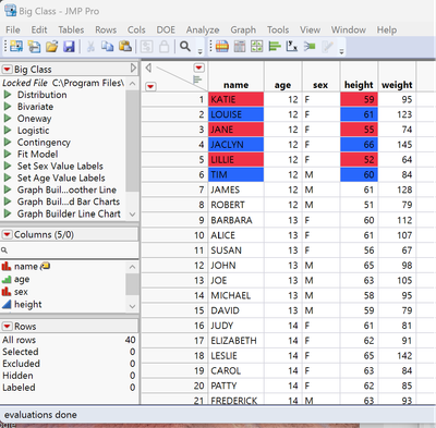

txnelson
Re: How to use JSL to set the color gradient of a column in text format by the value of a numeric column?
Here is the only way I know how to do it
Names Default To Here( 1 );
a = {1, 3, 5};
b = {2, 4, 6};
:height << color cells( {{"Red", a}, {"blue", b}} );
theScript = Char( :height << get script );
theScript = Substr( theScript, Contains( theScript, "Color Cells" ) );
theScript = ":Name<<" || Substr(
	theScript,
	1,
	Contains( theScript, "Set Value" ) - 3
Eval( Parse( theScript ) );
Jim

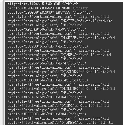

jthi
One place where you could get the color is from report html. You will have to perform conversion though
Names Default To Here(1);
m = 4;
Eval(EvalExpr(
	Column(dt, m) << set property(
		"Color Gradient",
		{"Green to White to Red", Range({Expr(Col Min(Column(m))), Expr(Col Max(Column(m))), Expr(Col Mean(Column(m)))})}
	) << Color Cell by Value;
(dt << get as report) << get html;
-Jarmo
txt = dt << get as report;
txt << Save HTML( "c:\tt.html" );
u = "c:\tt.html";
For( k = 0, k <= 60, k++,
	Try( d1 = Open( u, HTML Table( k, Column Names( 1 ), Data Starts( 2 ) ) ) );
	Wait( 0 );
lala
Level IX
Ask experts how to use RE to get these content?
How do I set the color in the name column after I get this?
Thanks!
