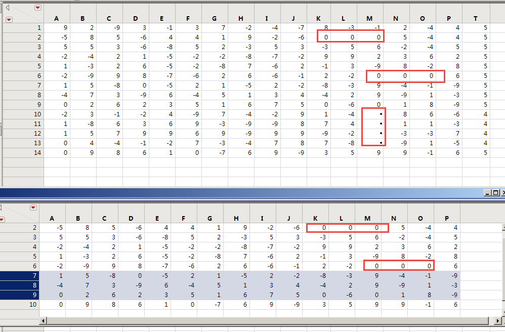

If a data table has more than 100 columns.Given that columns 11 -- 100 are in numeric format, how can use JSL to quickly filter out all rows in column 11 -- 100 that are not null.

Names Default To Here( 1 );
dt = Current Data Table();
dt << select where( Number( dt[Row(), Index( 11, 100 )] ) == 90 );
d3 = dt << Subset( Output Table( "t" ), Selected Rows( 1 ), selected columns( 0 ) );
Jim

I see that this is a way to sum multiple columns in the same row.
sumVec = (VSum(mat`))`;
I want to do this, but I don't know how to figure out the number of non-null columns in the same row in this way.
Thanks!
mat = dt[0, 11 :: 100];
nu = (Number( mat` ))`;
dt << New Column( "text", Numeric, Continuous, Values( nu ) );
dt << Select Where( :text == 90 );

How can do add a new column to the table and count the number of columns in row 11-100 that are not null?
txnelson
Re: How to use JSL to quickly filter out all the rows in a data table with multi-column values that are not empty?
  1. I know you know how to add a column to a data table
  2. You were just shown how to find rows that are not null
  3. So I must not be understanding what you are asking
Jim

I just want to add how do know if need to do the calculation what's the better way to do it?
When the number of columns is small, I use this method:
sum(if(abs(As Column(11))>=0,1),if(abs(As Column(12))>=0,1),if(abs(As Column(13))>=0,1),if(abs(As Column(14))>=0,1),if(abs(As Column(15))>=0,1))
Thanks!

Just for clarification,
Number( dt[Row(), Index( 11, 15 )] )
will not give you the same results as
The first equation will give you the count of non blank(null) values, while the second equation gives you the count of non zero values.
Additionally, a simpler version of the second equation is:
Sum( As Column( 11 ) != 0, As Column( 12 ) != 0, As Column( 13 ) != 0, As Column( 14 ) != 0, As Column( 15 ) != 0 )
Jim

Thank Jim!
I've tried. They're equivalent.
Number( dt[Row(), Index( 11, 15 )] ==5)
sum(if(abs(As Column(11))>=0,1),if(abs(As Column(12))>=0,1),if(abs(As Column(13))>=0,1),if(abs(As Column(14))>=0,1),if(abs(As Column(15))>=0,1))==5
Is for non-null values, not non-zero values.

You are correct....my error
Jim
