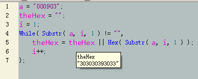

Re: How to use JSL how to modify decimal numbers to binary data in this format?
This is just a conversion to Hex
Names Default To Here( 1 );
a = "000903";
theHex = "";
i = 1;
While( Substr( a, i, 1 ) != "",
	theHex = theHex || Hex( Substr( a, i, 1 ) );
	i++;
Show( theHex );
This returns
theHex = "303030393033";

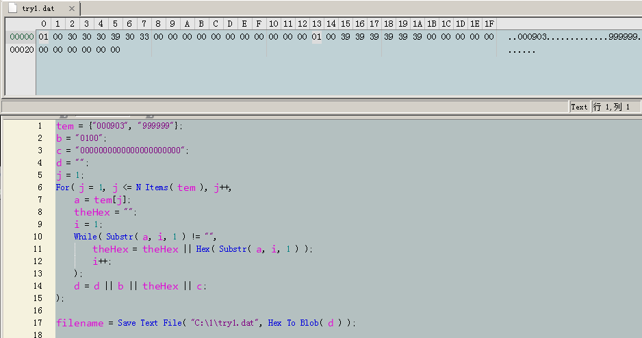

  • That's what's right. C has to have 34 zeros.
d="0100303030393033000000000000000000000000000000000001003939393939390000000000000000000000000000000000"

@lala , it's really hard to follow you, what you do and what you want. I think the suggestion of Jim is fine, and your problem is not in JSL but in file operations.
My feeling is that you shouldn't write binary data in a text file. If this would work, you should be able to re-read it, but this is not the case, JMP throws an errror.
Sorry, I've been wrong, Load/Save Text File supports BLOB, see scripting index. But I think anything else is going wrong during file operation. Below JSL with option for reading BLOB.
