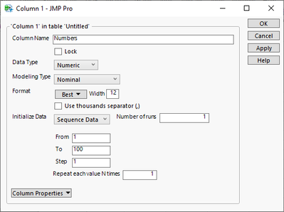

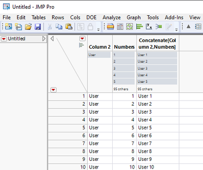

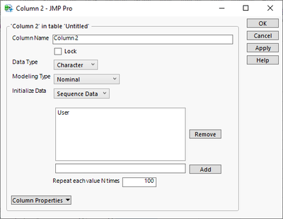

You could create one column with the numbers from 1-100 and then other with only "User". Then use formula to combine those two, remove formula and remove the original columns.
Column with "User" values should be first in the table

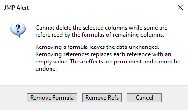

Then remove unnecessary columns if needed
Select Remove Formula here
