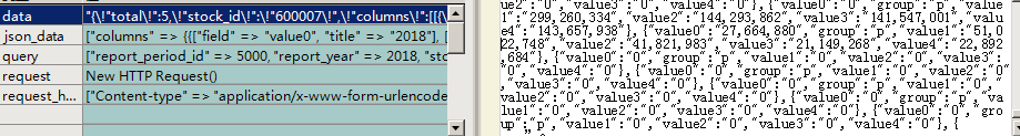

I just tried using the original VBA, continuing with ID 5000, and still being able to download.
"report_year=2018&stock_id=600007&report_period_id=5000"
Ryan_Gilmore
Re: How to use JSL form of "POST" WEB data?
These lines of code,
query = Associative Array();
query["report_year"] = 2018;
query["stock_id"] = 600007;
query["report_period_id"] = 5000;
are used to construct the query parameter list in the URL, e.g.
In the original code I supplied, the code had
query["period_id"] = 5000;
which would have given an incorrect query parameter list of
report_year=2018&stock_id=600007&period_id=5000

perfect.
Thank Ryan_Gilmore!
