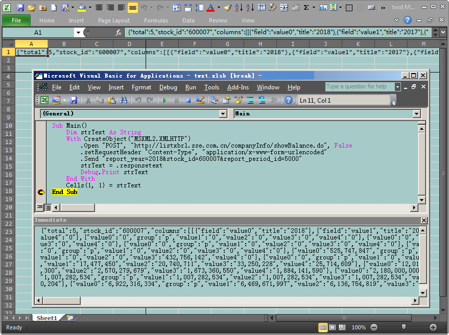

Below is the VBA code, can be downloaded to get the page data.
But I still haven't been able to convert it into JSL code.
Please give me help.Thank you very much!
VBA:
Sub Main()
    Dim strText As String
    With CreateObject("MSXML2.XMLHTTP")
        .Open "POST", "http://listxbrl.sse.com.cn/companyInfo/showBalance.do", False
        .setRequestHeader "Content-Type", "application/x-www-form-urlencoded"
        .Send "report_year=2018&stock_id=600007&report_period_id=5000"
        strText = .responsetext
        Debug.Print strText
    End With
    Cells(1, 1) = strText
End Sub

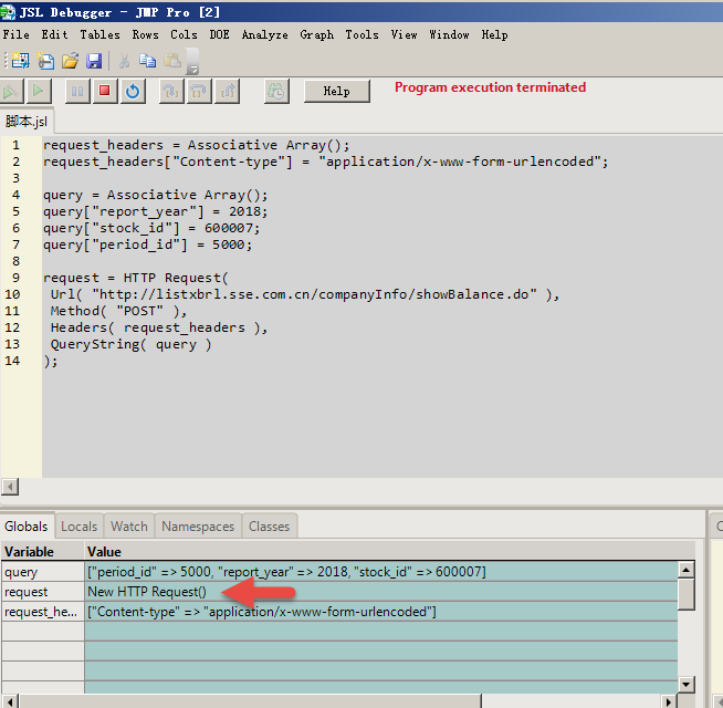

Ryan_Gilmore
Re: How to use JSL form of "POST" WEB data?
I think the following might be close to what you need,
request_headers = Associative Array();
request_headers["Content-type"] = "application/x-www-form-urlencoded";
query = Associative Array();
query["report_year"] = 2018;
query["stock_id"] = 600007;
query["period_id"] = 5000;
request = HTTP Request(
	Url( "http://listxbrl.sse.com.cn/companyInfo/showBalance.do" ),
	Method( "POST" ),
	Headers( request_headers ),
	QueryString( query )
lwx228
Level VIII
Thank Ryan_Gilmore !
This approach still hasn't worked.
It seems that this form of POST method, JMP application is not yet.

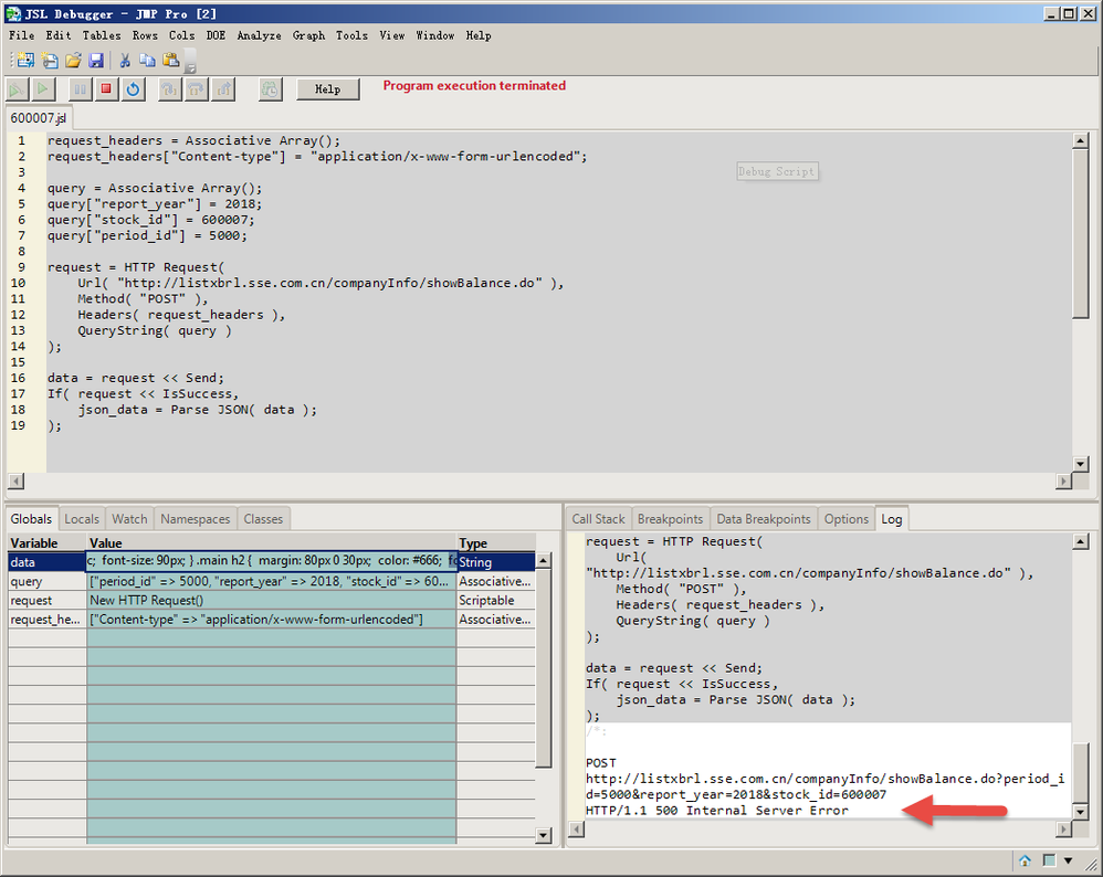

lwx228
Level VIII
get "DATA" of theta:
" <!DOCTYPE html PUBLIC \!"-//W3C//DTD XHTML 1.0 Transitional//EN\!" \!"http://www.w3.org/TR/xhtml1/DTD/xhtml1-transitional.dtd\!"> <html xmlns=\!"http://www.w3.org/1999/xhtml\!"> <head> <meta http-equiv=\!"Content-Type\!" content=\!"text/html; charset=utf-8\!" />
</p> </body> </html> "
Ryan_Gilmore
I notice that one of the parameters is incorrect. The code I suggested had "period_id" rather than "report_period_id" as shown in your original post. It's possible that may be contributing to the "500 Internal Server Error" message.
