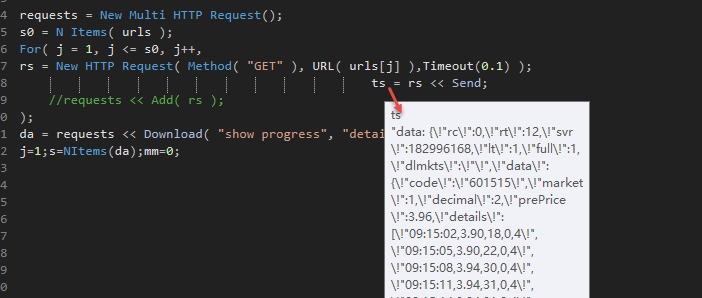

How to use JMP 17 multithreading to download such URL data?
When doing a Multi HTTP Request using JMP 17, encountering this download no temporary folder no files found,
But it's a discovery download.
3 REPLIES 3
lala
Level IX
回复: How can such urls be Multi HTTP Request with JMP 17?
How can this special download be merged into a large file normally.
Thanks!
requests = New Multi HTTP Request();
s0 = N Items( urls );
For( j = 1, j <= s0, j++,
rs = New HTTP Request( Method( "GET" ), URL( urls[j] ),Timeout(0.1) );
	//ts = rs << Send;requests << Add( ts );
	requests << Add( rs );
da = requests << Download( "show progress", "detailed" );//
j=1;s=NItems(da);mm=0;

lala
Level IX
Thanks!
This cyclic download method, I also master.
I do need to download JMP17's new features concurrently.
