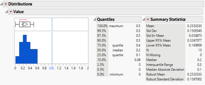

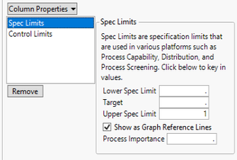

If I define the Spec Limit = the line will appear in histogram automatically.

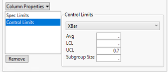

But why, when I define the Control Limit, the line doesn't appear automatically?

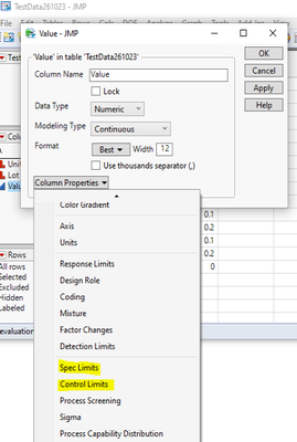

Is there any preference that I can define rather than insert new reference line manually?

As far as I know, only Spec Limits and Response Limits have the option to automatically added to graphic output.

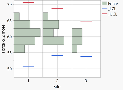

Temporal aspects are clearly lost when the temporal structure is neglected with a box plot.
But why is it not possible to generate a plot like this directly via the Distributions platform?
dt = Open( "$SAMPLE_DATA/Quality Control/Phase Historical Data.jmp" );
dt:Site << Data Type( Character );
myControlChart = dt << run  script("Control Chart Builder");
myLimits = myControlChart <<Save Limits("in New Table");
dtsplit = myLimits  << Split(
	Split By( :_LimitsKey ),
	Split( :Force ),
	Group( :Site )
dt << Update(
	With( dtsplit ),
	Match Columns( :Site = :Site ),
	Add Columns from Update Table( :_LCL, :_UCL ),
	Replace Columns in Main Table( None )
Graph Builder(
	Variables(
		X( :Site ),
		Y( :Force ),
		Y( :_LCL, Position( 1 ) ),
		Y( :_UCL, Position( 1 ) )
	Elements(
		Histogram( X, Y( 1 ), Legend( 14 ) ),
		Line Of Fit( X, Y( 2 ), Y( 3 ), Legend( 15 ) )
	Split( :Force ),
	Group( :Site )
dt << Update(
	With( dtsplit ),
Graph Builder(
	Variables(
		X( :Site ),
		Y( :Force ),
	Elements(

WebDesignesCrow
Re: How to make UCL appear in Histogram?
I like this visualization. Thanks @hogi
You know, common issues that I've seen in my organization.
They follow statistics to calculate Control Limit & propose control limits that is outside of spec limit (customer requirement) which I think is ridiculous.
So, I just want to visualize the comparison (easy to explain)
hogi
Level XIII
Yes, to detect analysis errors and discuss them, the visualization in Jmp is a great advantage!
How good that we have GraphBuilder :)
It can replace many of the other [sometimes limited] analysis platforms :)
