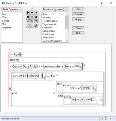

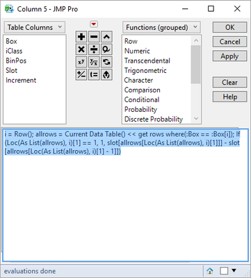

txnelson
Re: How to use Dif/Lag function by Column group
If the absolute order of the original data is not important, sorting the data and using the Dif function will work.  However, here is a formula that you can use that will calculate the increment without having to sort the data.
i = Row();
allrows = Current Data Table() << get rows where( :Box == :Box[i] );
If( Loc( As List( allrows ), i )[1] == 1,
       1,
       slot[allrows[Loc( As List( allrows ), i )[1]]] - slot[allrows[(Loc( As List( allrows ), i )[1])-1]]
Jim

Highlighted
txnelson
The example is a formula for a new table, not a JSL standalone script.  Create a new column, and paste the formula into the formula for the column, and it will generate the incremental values you want.
Jim
