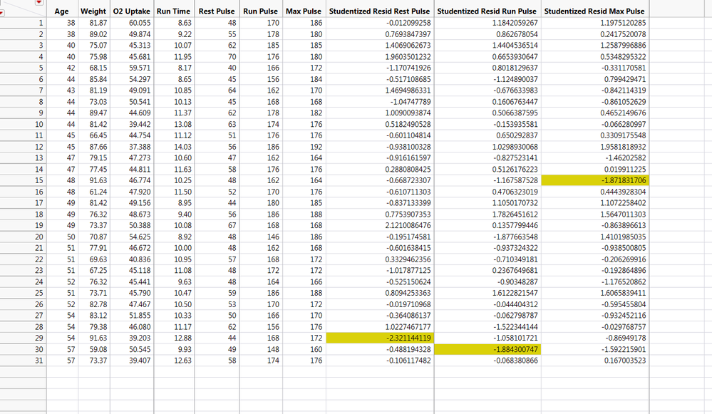

I have a script that colors the minimum values yellow for every Studentized column in a table. I want to also highlight values adjacent to these values in raw columns. For example, for Studentized Resid Rest Pulse, the cell adjacent to -2.321144119 in Rest Pulse column i.e. 44. How can I do this in jsl? Can regex or match be helpful? Thank you  Capture.PNG
dt = current data table();
col = dt << get column names( string );
nc = N Items( col );
For( i = 1, i <= nc, i++,
 Cols = Column(dt,i);
 If( Contains( col[i], "Studentized Resid" ),
 Min = dt << get rows where(as column(Cols)==(Col Min( Cols )));
 Cols << color cells(Yellow, Min);

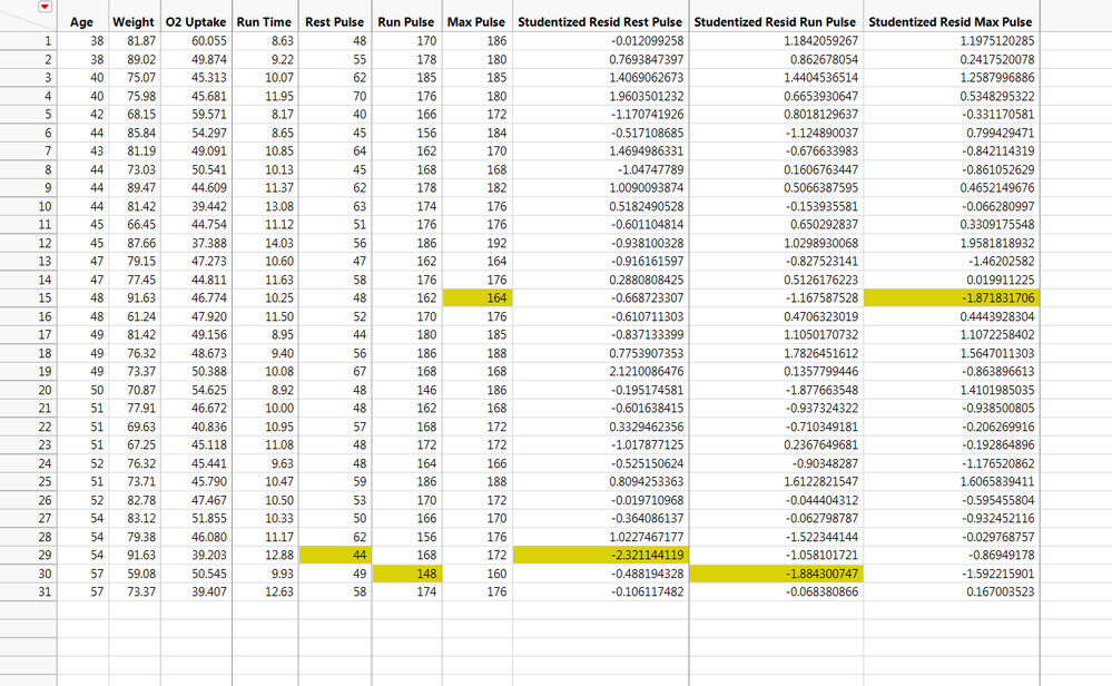

@txnelson Hi Jim, I'm sorry if I am missing anything here. I wanted to also highlight the adjacent raw columns for every studentized column. I am not able to make this work.

Is the Substr() function what you're missing?
resid_colname="Studentized Resid Rest Pulse";
//There are 19 characters in "Studentized Resid "
orig_colname = substr(resid_colname, 19);
show(orig_colname);
orig_colname = "Rest Pulse";
-Jeff
