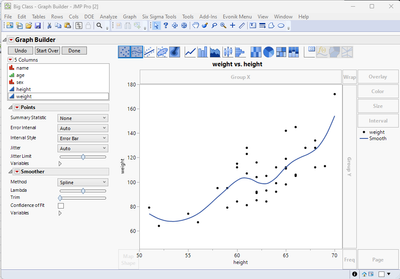

  Go to Graph Builder, then you can click and drag your columns to the respective axes. Here it is with just one column for each axis:
  If you click and drag your same column for the x-axis and then move it off to the right of the original axis, like so:

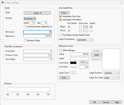

you'll get a graph with the same curve on two axes. Double click the left axis and you'll get the axis setting window, this is the default:

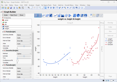

  Chang ethe Maximum value for the x-axis to whatever your new x2 value is, in this case I'm choosing 60, and change the Increment value to whatever you want. In this case 1, then click OK:
and your graph will now look like this:

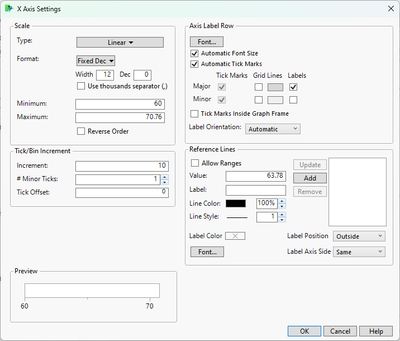

  You'll do something similar for the right x-axis, but change the Minimum to the same value as what you had before for the maximum on the other axis, in this case 60. I'm leaving the max default to what it says, and changing the Increment to 10. Click OK.

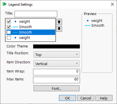

One very small thing you can add is to hide those "extra" legend items. Double click on legend and unselect them
Note depending on your data, be sure that it is obvious to the readers that the x-axis is changing as it can be very difficult to spot.
-Jarmo

  As an example, I'm using the Big Class.jmp file and graphing :weight vs :height, but I also use :height as a second x-axis. I graph the first x-axis from 50-60 and the second from 60-71 and set the increments to 1 and 10, respectively. You get a graph that looks like this:
  So in a way it's possible to do that, but you'll have two x-axes and then the thin vertical line separating the two graphs (this is with graph spacing set to 0). It may not be exactly what you're looking for, but it's a solution that could work.

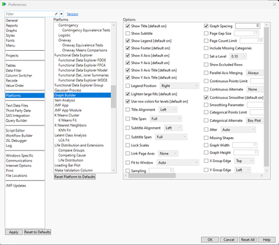

  The first thing you'll want to do is change your preferences so the graph spacing is zero, not just unchecked (default).
This time, I actually set the graph spacing to 0. Last time, I just unchecked the box in preferences (leaves vertical line as before), but if you actually set it to 0, then there is no vertical line separating the graphs. To get to preferences, go File > Preferences, Select Platforms and then scroll down to select Graph Builder:
  Make sure the checkbox for Graph Spacing is marked, and then set the spacing to 0.

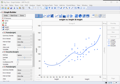

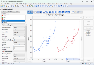

  Your graph should now look like this:

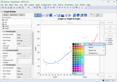

  To change the color of the second graph, right click the marker icon (do the same for the line icon), and select the correct color so that it's the same as the left-hand graph:
-Jarmo
