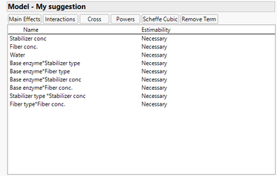

This would be my best guess for a model: see the attached screenshot from JMP.
Should other terms be included or??

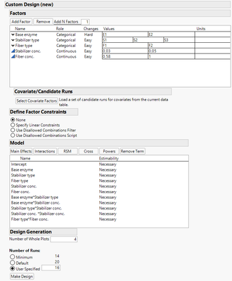

I think that the sequential approach sounds like a good idea. Since the people I am helping with this design would like to know which of the stabilizers and fiber types work best. I guess the split-plot is also needed for the base categorial factor. The the design would be the following:

Yes, I am aware that you should cross the process and mixture variables. However in this case for example with the two categorial factors: Fiber type and Stabilizer Type. We expect based on domain knowledge that they should not interfere with each other. Is it then never "okay" to remove certain terms to simplify the model and get fewer runs??

@Bertelsen92 , I am not saying that you must include all 2-way interactions. However, I think it would be important to put the Stabilizer Type*Stabilizer conc. and the FiberType*Fiber conc. interactions in the model. And to go one step further, the "interactions" in a mixture model are actually estimating curvature. That fact along with the fact that mixture designs are really all about developing predictive models, I would recommend ALL 2-way interactions (and the special cubic terms), if at all possible. Too bad resources are not free to allow that!  :)
