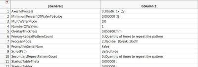

Please see the attached data table.
I would like to do the following using a JMP script:
1. Copy the column values in the column "[General]" and transpose them into the column name of a new table.
2. Copy the column values in the column "Column 2" and transpose them into row 1 of a new table.
Can anyone provide me with some guidance?
