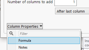

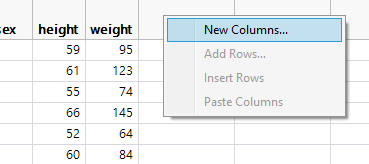

To create a column with a formula, right click on the column headers to add a new column:
 in the column menu, add a formula
and paste the formula from @jthi 's post.
