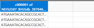

JMP2021
Level III
How to split a 500-character long string into 500 columns, one char per column?
Is there a simple way to split a column containing 500-character long string into 500 columns, one char per column?
I am using JMP17.

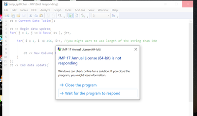

JMP2021
Level III
Re: How to split a 500-character long string into 500 columns, one char per column?
My JMP is not responding when I try your scripts. IT probably because that my table is large. I guess it will work for a smaller table.
