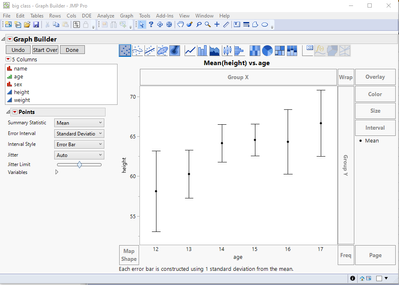

Re: How to specify error bar values for graph in JMP
Dear Txnelson, Thank you very much for the reply.  I followed as you suggested. But I wonder why I am not getting the error bars displayed. I have attached the graph for your reference. Please let me know what went wrong and
I actually have my standard deviation values which I would like to use for my graph bars (custom error bars option).  Please guide me..

txnelson
How many data points are in your data table?
What version of JMP are you using?
Jim
