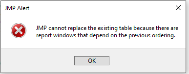

Not sure what you mean by missing characters. But in any case, the issue is the same even if the call to the function above is replaced with a simple Sort Table:
DataTable1 << Sort (By( Column(snCol), Column(dtCol)), Replace Table);
I get the following alert, even though the only open window for DataTable1 is the application that called the Sort function.
