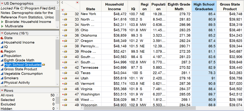

Do you have both the rows labeled as well as the column label turned on? You should see yellow label symbols as row states and next to the column with the values you wish to label in the left side columns panel.  For example, I want to label all the US States by the percentage of high school graduates.Demographics.PNG
Steps:
-Rows menu>Row Selection>Select All Rows
-Once all the rows are selected, go to the Rows menu>Label
-Right Click on the column with the values I want to label by and select Label
-Olivia

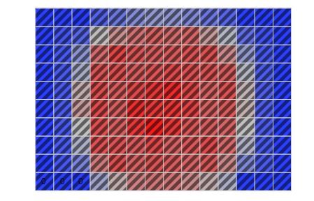

Thanks a lot for getting back to me. By doing  what you suggested, we get all the square box selected but there are not the number inside. I attached the result of doing  your procedure. In addition to this I use your procedure for builing a non map shape graph and it work i.e. I can see the values of the point inside the graph. Looks like as soon I transform my column in Map role using an external file for the Shape name use option something goes wrong.

Thank you for attaching the image of your result. I see there are some 0 labels on the left bottom 3 squares. This combined with the note that you can see the labeling when it is not a map shape leads me to believe it may have to do with the font size of the labels in your map fitting into the squares. To determine if this is the cause, when in your map try going to the Windows menu>Font Size>Decrease Font Size and decrease the font size a couple of times. Alternatively you can use the keyboard shortcut of Ctrl-Shift-Minus. Do your labels now start to appear?
If this works for you, you can control the label size directly by going to File>Preferences>Fonts. The labels are controlled by the text font.

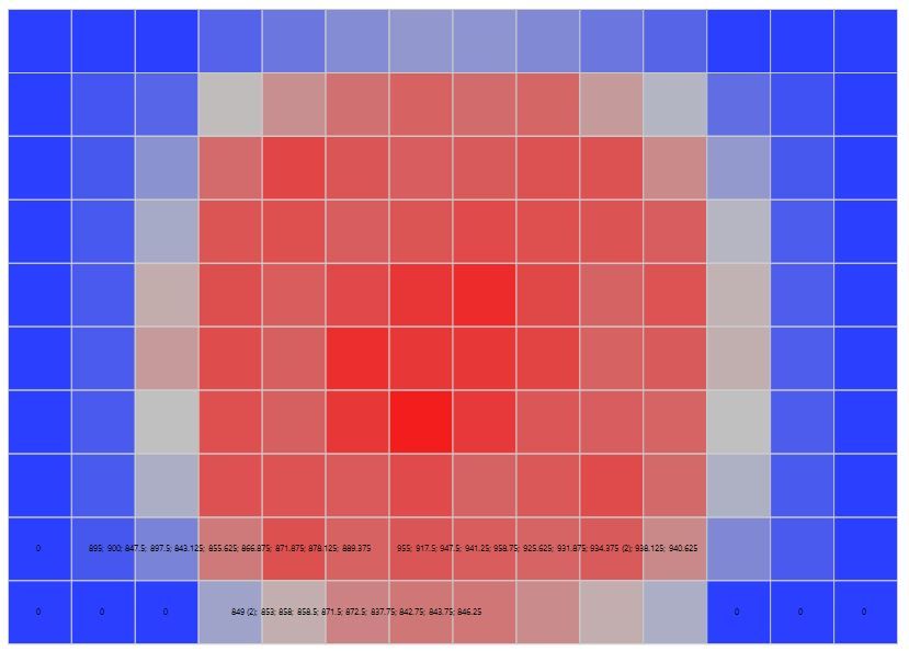

Thanks once again for gettig back to me. By decreasing the font size using Ctr-shift-minus,  other number appears but unfortunately  they do not go inside the other squares. I attached the image, the 0 sems to be ok but the rest is not.

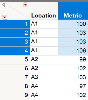

Do you have multiple rows in your datatable per location on your map shape?  For instance, like the example table below which is giving the labeling of 100; 103(2); 106 for A1. Multiple.PNG

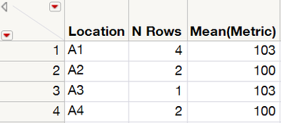

To label by the average of the location, create a summary table at the location level by placing the location variable in the group spot under Tables>Summary. This will give you the example table below.  Make sure the column of the metric is formatted to the correct decimal place you would like to display in the label.
