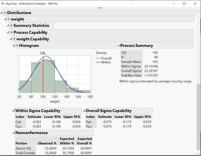

In addition to both other replies, I think this is best covered by the process capability platform already. So if you add a spec-limit to that column (i.e. USL=100 for the column weight in Big Class.jmp like @jthi did in his script), you will get in the distribution platform also a process capability, which shows you the Nonconformance shares (55% = 22 members of Big Class.jmp).
There you can also see the difference of real nonconformance to the modeled nonconformance share. The modeled one is only ok, when the model fits the distribution well.
