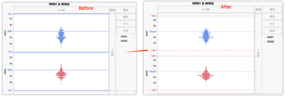

Hi, JMPer I have used JSL to load spec limits into column Properties. But when generate graph or distribution charts, the spec limits' color is bule.
My question is:
1.How to change the colors to red and line to dot?
2.I used chinese vision, how to change it to english?

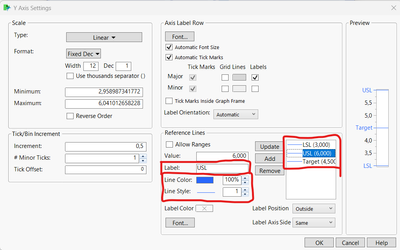

If you right-click on the left axis and select "Axis Settings...", you'll have access to more customization for the specs reference lines aspects and names :
You can do it manually, save your graph preferences, and then look at the script so that you can re-use automatically the settings you have modified.

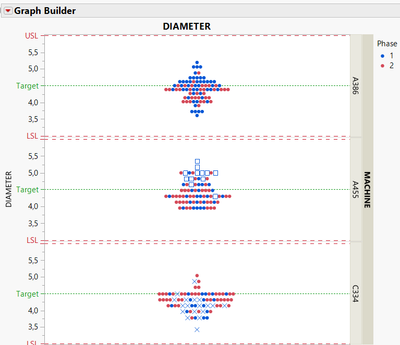

For this graph :
My JSL script now looks like this (you can see the new properties for reference lines just after the first "scalebox" with the functions "Add Ref Line" and the settings behind) :
Graph Builder(
	Size( 570, 503 ),
	Show Control Panel( 0 ),
	Variables( Y( :DIAMETER ), Group Y( :MACHINE ), Color( :Phase ) ),
	Elements( Points( Y, Legend( 14 ) ) ),
	SendToReport(
		Dispatch(
			"DIAMETER",
			ScaleBox,
			{Add Ref Line( 3, "Dashed", "Medium Dark Red", "LSL", 1 ),
			Add Ref Line( 6, "Dashed", "Medium Dark Red", "USL", 1 ),
			Add Ref Line( 4.5, "Dotted", "Medium Dark Green", "Target", 1 )}
		Dispatch(
			"400",
			ScaleBox,
			{Legend Model(
				14,
				Properties( 0, {Line Color( 21 )}, Item ID( "1", 1 ) )
I hope this answer will help you,
