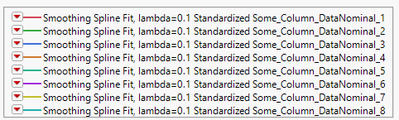

When generating a bivariate plot (for example) - the text box size is to narrow for the inside writing.
After running the script i need to CTRL Right click the text box are and choose "Wrap Text" then choose the size i want.
Is there any way to default choose the size? or any way to add to script to generate the plot with the desired wrap text size?
 For example:
 text box result
Text box results i want

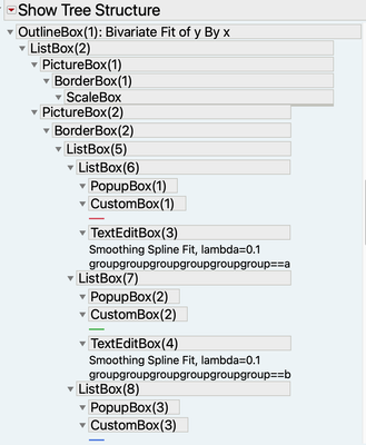

Hello, This can be done as follows. You will want to read up on navigating JMP's "Display Tree" to see how reports are constructed, and the xPath ( ) command, for the convenience it affords.
What is needed here is to answer 2 questions:
1) In what type of structure does the text reside, and
2) How best to access these structures conveniently--all at once, if possible.
The << show tree structure message can help with 1), and xPath ( ) can often help with 2).
Run the following script. I've put a stop ( ) in it after using a << show tree structure message. Examine the tree structure and you will notice that the text you want to change lies in each of the TextEditBox structures subordinate to PictureBox( 2 ) in the report.
Knowing this, you would create the remainder of the script as I have. In the final script, of course, you would leave out the lines with rep << show tree structure and stop ( );
Names Default To Here(1);

Fit Where( :groupgroupgroupgroupgroupgroup == "d", Fit Spline( 0.1, {Line Color( {66, 112, 221} )} ) ) ); rep = report(biv); rep << show tree structutre; stop (); ////////////////////////////////////////////////////////////////////////////////////////////////////////////////////////////////////////////////////////// // Use the tree structure to notice where the smoothing fit descriptions lie. // They are in the 2nd picturebox of the report. //get the picture box holding the spline fit descriptions picBox = report(biv)[picturebox(2)]; // set the width of the textEditBoxes within the picture box, all at once, using xPath // width is in pixels... use something you know will be well long enough. ( picBox << xPath("//TextEditBox") ) << set wrap width ( 1000 );
