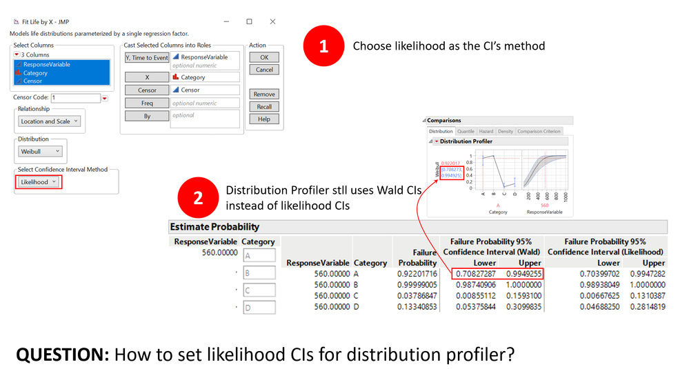

Hi everyone,
This seems to be a simple question, but I cannot find the solution.
In Analyze toolbar > Reliability and Survival > Fit Life by X, there is a distribution profiler.
My problem is that the confidence intervals (CIs) shown here are using Wald's method, even when I selected the likelihood as the preferred CI method.
Unfortunately, I also cannot find the button to change from Wald to likelihood CI.
So, my question is simply "how to change the CI's method from Wald to likelihood in the distribution profiler?"
Thank you so much in advance for your help.
Note: I am currently using JMP17.
Please find below the picture that summarize my question.

Thank you very much for your effort to elaborate the question!
What you observed is the behavior by design. And you won't be able to see Likelihood Confidence Intervals in profilers.
The reason is due to computation cost and usability. Calculating Likelihood Confidence Intervals is computationally intensive.
It is by design not to show Likelihood confidence intervals in the profiler, or the profiler will be unusable. That is true for all profilers in reliability platforms. And probably true elsewhere. I am glad that you found the places to get Likelihood confidence intervals for predictions. And you shall see when you have enough failure observations, the two types of intervals are rather close. If you have fewer failures, Likelihood confidence intervals are more trustworthy, and you should be alerted by the wide Wald intervals in the profiler first.

Hi Peng Liu,
Thank you very much for your answer. It is a bit unfortunate though that we cannot have this feature due to it being the computationally heavy operation.
