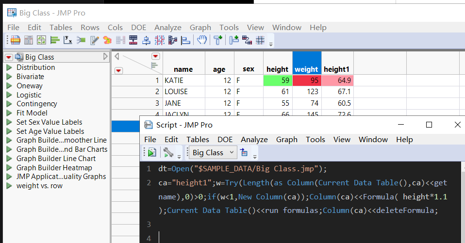

How to set color gradients for specified multiple columns stroke by stroke?
Thanks Experts!
dt=Open("$SAMPLE_DATA/Big Class.jmp");
ca="height1";w=Try(Length(as Column(Current Data Table(),ca)<<get name),0)>0;if(w<1,New Column(ca));Column(ca)<<Formula( height*1.1 );Current Data Table()<<run formulas;Column(ca)<<deleteFormula;

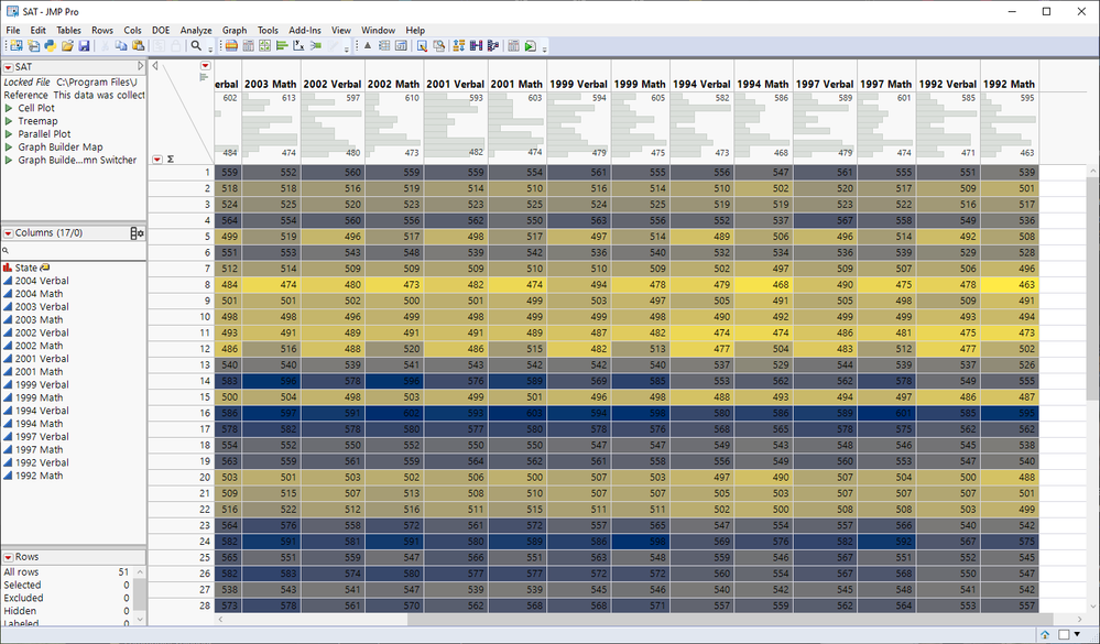

No real idea what was requested here, but here is an attempt of a script to row wise gradient coloring
/*""" Gradient color cells rowwise (using whole data)
Author: jthi
Creation Date: 2025-06-08
Creation JMP Version: JMP Pro 18.2.0
Names Default To Here(1);
dt = Open("$SAMPLE_DATA/SAT.jmp");
dt << Delete Columns({"% Taking (2004)", "X", "Y", "Population", "Latitude", "Longitude"});
cont_cols = dt << Get Column Names("Continuous", "String");
m = dt[0, cont_cols];
mn = (m - Min(m)) / (Max(m) - Min(m));
colors = Heat Color(mn, "Cividis")`;
idx = 0;
dt << Begin Data Update;
For Each({contcol}, cont_cols,
	For Each Row(dt,
		idx++;
		Column(dt, contcol) << Color Cells(colors[idx], Row());
dt << End Data Update;
wait(0);
write("\!NDONE");

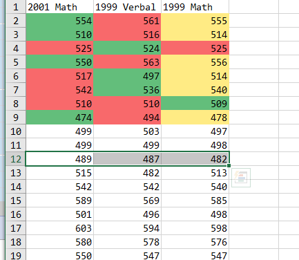

lala
Level IX
Re: How to set color gradients for specified multiple columns stroke by stroke?
The color change of each row is only based on the comparison of the values in the three columns of that row.
Thanks!
jthi
You have only three values for each row and wish to have just those three colors?
-Jarmo
jthi
Something like this?
