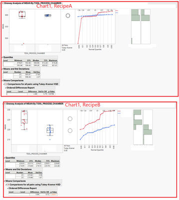

How to select & exclude by UniqueVals combo of two columns?
So I'm stumped here. I'm trying to output a screened dt of just data that is statistically significant, based on two columns: Chart_ID & Recipe_ID. I can get it to work w/ a single column but can't figure out two columns.
  • I'm plotting the raw data using Oneway (y=mean, x=chamber, BY:Chart_ID, Recipe_ID) and running the All-pairs Tukey tTest.
  • Then taking the combined pVal data table.
  • then selecting all rows where pVal >0.05 and excluding
  • then creating a summarize list of the UniqueVals by Chart_ID (this is all Chart_ID's with significant pVals.)
  • then selecting all rows in source dt w/ matching UniqueVals
  • then inverting selection and excluding
  • --> this leaves the source dt with only data that is tTest significant by Chart_ID.
I can't figure out how to add in the Recipe_ID into the summarize UniqueVals.
Is there a better way to end up w/ a source dt that has excluded all the Charts/Recipes that are not significant?
