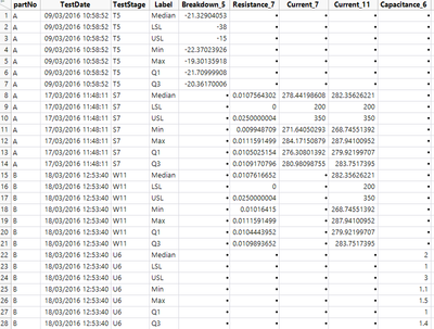

I have incoming data similar to the attached data table.
I would like to (as an example)
  • save the row values appearing (first/top) in column Breakdown_5 against rows USL/LSL (under Label) for T5 (under TestStage) as limits in Breakdown_5 column property, similarly
  • save the row values appearing (first/top) in column Resistance_7 against rows USL/LSL (under Label) for S7 (under TestStage) as limits in Resistance_7 column property
  • save the row values appearing (first/top) in column Current_7 against rows USL/LSL (under Label) for S7 (under TestStage) as limits in Current_7 column property
  • save the row values appearing (first/top) in column Current_11 against rows USL/LSL (under Label) for W11 (under TestStage) as limits in Current_11 column property
  • save the row values appearing (first/top) in column Capacitance_6 against rows USL/LSL (under Label) for U6 (under TestStage) as limits in Capacitance_6 column property
In general, how do I write a script in JSL to apply spec limits corresponding to the LSL/USL rows (under Label) appearing (first/at the top) under columns of measured data (Breakdown_#, Resistance_#, Current_# and so on) corresponding to correct TestStage#, where # refers to the test stage number.
