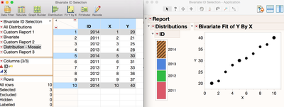

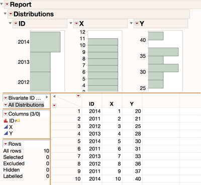

In this case we created a simple data table like you described with three columns: ID, X and Y, with several IDs having multiple rows of different X and Y measurements. We then combined the datatable and then a distribution of the columns into one window (Combine Windows in JMP to get a Custom Report view) below so you can see our initial setup.

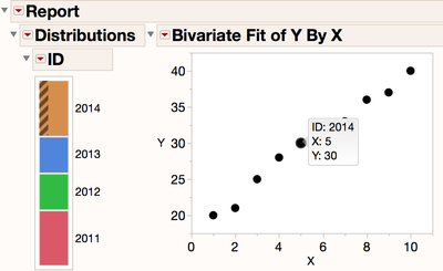

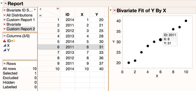

Then we created a graph showing the Bivariate Fit of Y by X.  At this point if you select a point, you are really selecting only based on the X and Y coordinates.  Getting the ID label for that point to show up is no problem, but this will only shade (select) that exact point back into your data table.  So the problem is that the Bivariate would be looking for matches based only on similar X and Y coordinates, and not common IDs.  See the next Custom Report view.8980_Custom Report 2.png
So thought maybe we could made this a really easy two step process by creating a "helper" graph next to the Bivariate that would allow me to then select all the ID points of interest with one click.  To do this I created a Distribution for ID (which I made into a nominal data column type for better selection capability) and then turned all display options off except for a Mosaic Plot.  Then joined both the Distribution and Bivariate graphs into one window to get another Custom Report view.  Then under the red triangle in the Report header we selected the Edit Application button that brings up the Application Builder workspace (after selecting the underlying datatable).  Now in the Application Builder it is as easy as selecting the first Distribution Mosaic Plot graph, right clicking on it and selecting Use As A Filter.  Now I can have a two click solution...where first I select the point on the Bivariate Fit Y By X chart that I care about, and then can slide over and select (click direction on) the full ID in the partially shaded Mosaic that will now highlight all the similar IDs on the Data Table.  Also nice to graphically see on the Bivariate Fit Y By X chart all the points corresponding to the same ID number after we select it on the Mosaic Plot.
