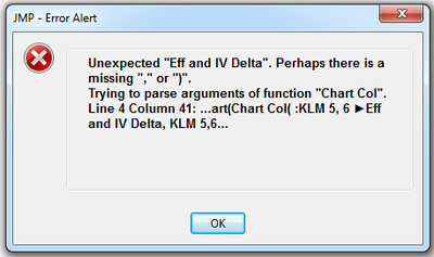

When i run this script, this error box appear.

The problem is your column name, "KLM 5, 6 Eff and IV Delta, KLM 5,6 Eff Line Delta", has an embedded comma. That's okay but you'll need to use the Name()  function when referring to it. Like this:
obj= Control Chart(Chart Col( Column( :Name( "KLM 5, 6 Eff and IV Delta, KLM 5,6 Eff Line Delta" ))));
I think that will correct the error you're getting.
-Jeff
