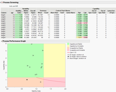

Hi JMP,
Let's take the big class as an example.
Do you have a JSL script example to export the process performance graph as a JPEG/PNG? Currently, I manually copy the graph to clipboard and paste it at my pptx. Wish to have automate way of doing it. :)
By the way, I set a random number for the spec limit just to produce the process performance graph.

Here is a simple script to show one way of saving the graph to PowerPoint
Names Default To Here( 1 );
dt = Open( "$SAMPLE_DATA\semiconductor capability.jmp" );
ps = Process Screening(
	Process Variables( :NPN1 ),
	Control Chart Type( "Indiv and MR" ),
	Process Performance Graph( 1 )
Report( ps )["Process Performance Graph"] << save presentation( "$TEMP\mygraph.pptx" );
Open( "$TEMP\mygraph.pptx" );

HI Nelson,
Appreciate your prompt response. It works well ! :)
