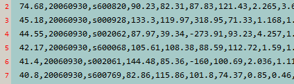

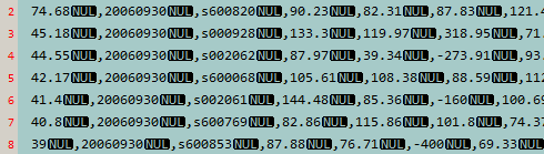

If open the CSV generated by JMP with Note.exe, it will see these scrambled codes,
This CSV file is opened in Excel, and then saved as a CSV file. This new CSV file is opened and displayed in Note.exe is normal.

What are your Export Settings?
Looks like there is a Special character used as delimiter for columns, that is not shown properly in "note.exe".
