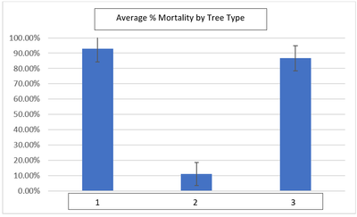

This is my first post here as I am very new to JMP pro. I am a novice at stats and could use some guidance. I have a data set where 1 column is tree type (lets say type 1, 2, or 3) and the other column is binomial (1,0) dead or alive. I am trying to get the statistical significance for the difference in average % mortality by tree type.
Basically I need the hard stats to explain the figure below:
Any help would be really appreciated!
