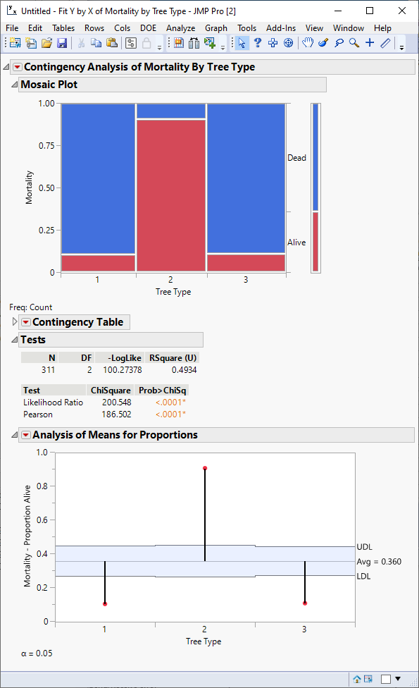

@Mark_Zwald helped you with more options. I have a few more, too. You can ask Contingency to compare the group means to the overall mean by clicking the red triangle and selecting Analysis of Means for Proportions.

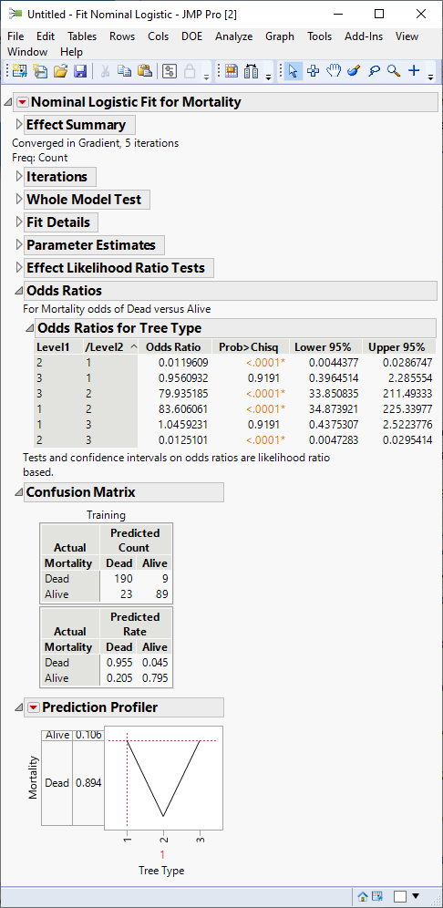

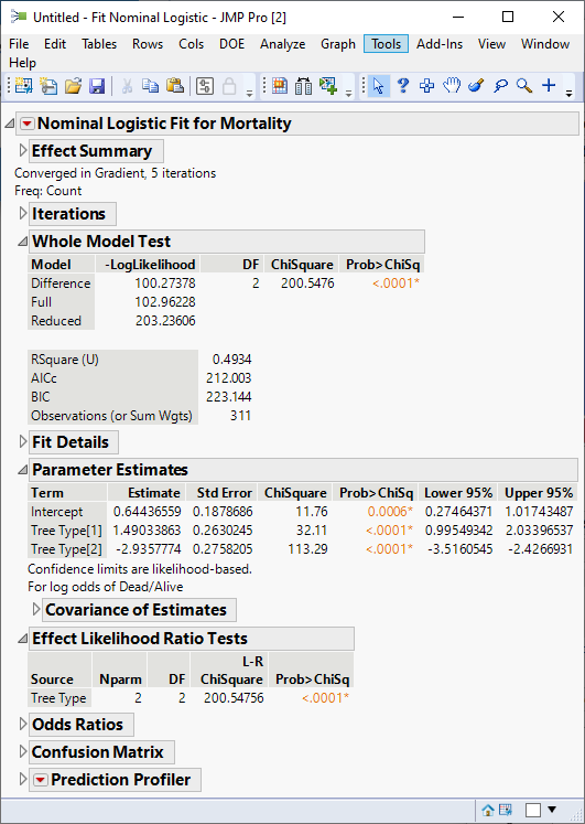

You can even more information to compare one Tree Type with another. from Nominal Logistic Regression platform. Select Analyze > Fit Model. Cast Maturity in the Y role, add Tree Type to the Effects, and cast Count in the Freq role.
Notice that where the same result is presented in both platforms, the value is the same. There is some overlap in content. Let's look at some of the unique information that is available in the second platform.
The Odds Ratios tell you how much more or less likely the outcome will be Dead compared to Alive for different Tree Types. The Confusion Matrix tells us how well the model predicts the outcomes. Finally, the Prediction Profiler allows you to predict the probability of both outcomes for any Tree Type.

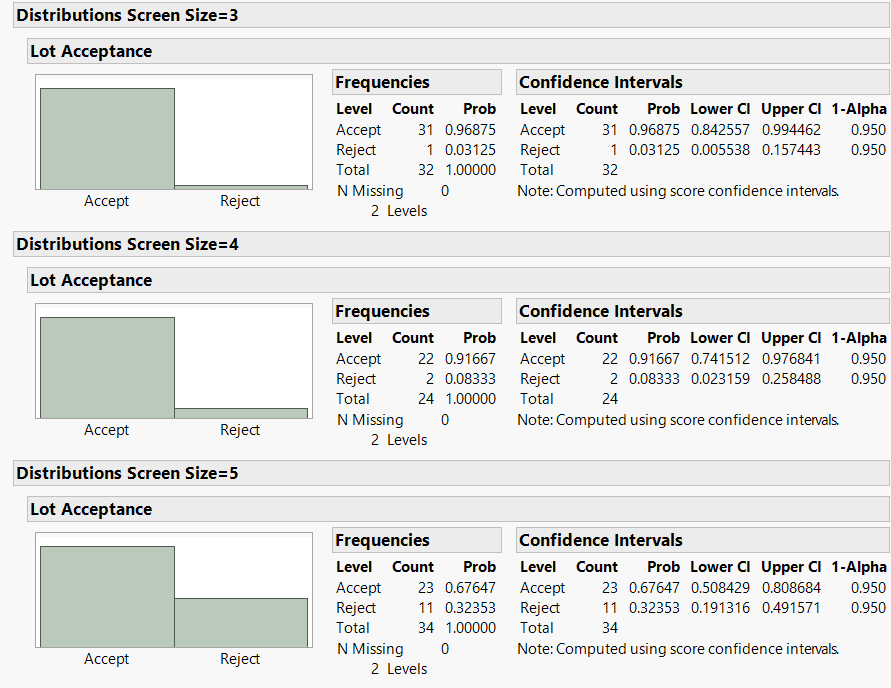

You will want to use the Distribution platform for this.  Place the Dead/Alive binomial column as the Y and put the 1/2/3 group column as the By role.  From the inner red triangle of the distribution report, select Confidence Interval and choose the interval of interest.  This will give you the CI for the probabilities using a binomial distribution.

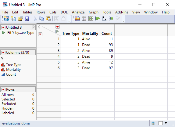

Here is an additional analysis that might help. I create a mock-up of your data:
I selected Analyze > Fit Y by X. I cast Mortality in the Y role, Tree Type in the X role, and Count in the Freq role. I get the following analysis when I click OK.
Please see the documentation for the Contingency platform.

You would get that from the confidence intervals which are shown in the distribution report.  Unfortunately the Contingency report will not give you those CI intervals, but it will tell if the Factor X has a significant impact on the probabilities of Response Y.  Being able to get these CI intervals in the Contingency report would be a nice-to-have feature.

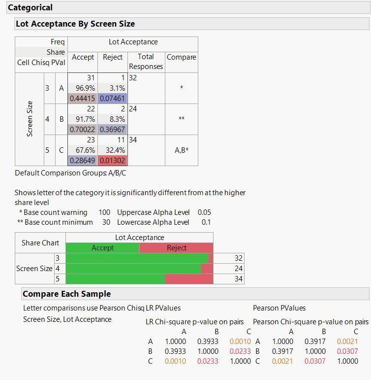

The Categorical platform (Analyze > Consumer Research > Categorical) can give you LR/Pearson p-values for each sample pairing (see below).

Ok, sweet, so this tells me that A and B are significantly different and B and C are also significantly different?

A and C are not statistically different probabilities from each other, but B is statistically different from A and C.
