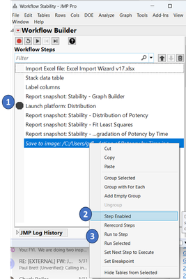

There are many ways to control (limit) the scope of your workflow recorded steps.  See annotated image below.
- can click and delete steps to trim scope of workflow...
1: click in left border to toggle a stop point (e.g. prior to file save/close), can proceed beyond with another click of "play" button
2: Right click on steps that you want to exclude and "Disable Step" (disabled step name format changes to Italics)
3: right click on temporary end point, and choose "run to step" to launch and cease at selected step
>>For more info- Check out this "mastering" session which has an overview of not just workflow, but also how it relates to the log and scripting. Mastering JMP: Automating Your Analysis Workflow    Other info searchable at Learn JMP
