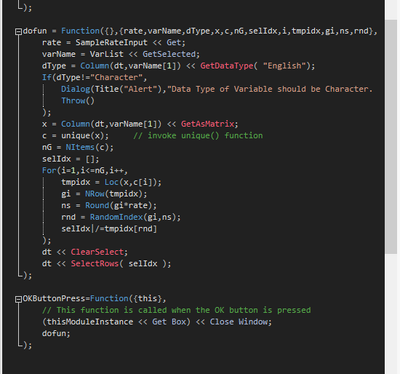

I haven't used Application builder myself, but based on Sample application "Data Table Application", << get should work just fine.

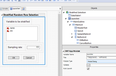

Changed Launcher to modal:

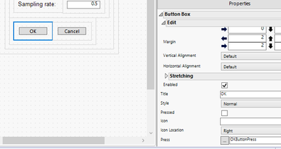

Ok button executes OkButtonPress
and OkButtonPress calls doFun function
which has
rate = SampleRateInput << Get;
-Jarmo
