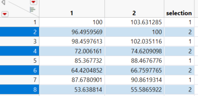

I'm looking to replace alternate values in a column in using scripting. I've managed to select the values in the table but I'm struggling to find a way to replace them in just 1 column only.
This is my code so far:
Names Default To Here (1);
dt << new column ("selection", formula (sequence (1,2,1 ))); dt:selection << delete formula; dt << select where(:1 & :selection !=1);
This is the table it creates:
I want to replace the values highlighted in the first column with 0. Any advice on how to accomplish this would be appreciated. Thanks!
txnelson
Re: How to replace selected values in a column with JSL
:Name("1")[ dt << get selected rows ] = 0;

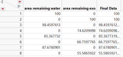

By combine I mean have all the data in 1 column and disregard the 0 values, to end up with a table like this:
txnelson
dt << new column("Final Data", formula(:Area remaining water +
:area remaining exo));
