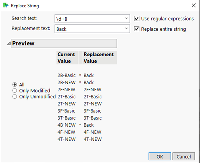

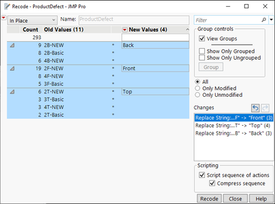

You can use Recode and Replace string multiple times. I don't know your data, so I'm not sure what would be the best way (I would maybe go with simple regex and if more complicated is necessary you could also do that)
Repeat this for all with their own patterns
And JMP creates you a script
// Recode column: ProductDefect
Local({dt},
	dt = Data Table("Sheet1");
	dt << Begin Data Update;
	dt << Recode Column(
		dt:ProductDefect,
		{Regex(_rcNow, ".*?\d+B.*", "Back", GLOBALREPLACE),
		Regex(_rcNow, ".*?\d+T.*", "Top", GLOBALREPLACE),
		Regex(_rcNow, ".*?\d+F.*", "Front", GLOBALREPLACE)},
		Update Properties(1),
		Target Column(:ProductDefect)
	dt << End Data Update;
If you don't want to do it in place,run recode without that enabled
-Jarmo

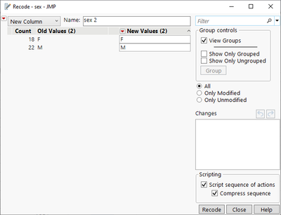

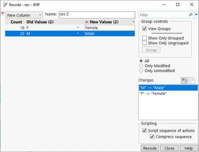

Recode platform can create this type of conversion for you easily.
Local({dt, col1},
	dt = Data Table("Big Class");
	col1 = dt << New Column(dt:sex);
	col1 << Set Name("sex 2");
	dt << Move Selected Columns({col1}, after(dt:sex));
		dt:sex,
		{Map Value(_rcOrig, {"F", "Female", "M", "Male"}, Unmatched(_rcNow))},
		Target Column(col1)

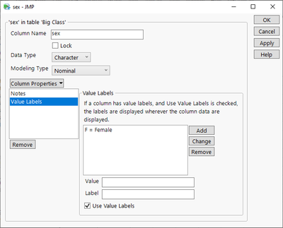

You might also want to consider using Value Labels column property
It won't change the data in the table, but you will see the "recoded" values
Local({dt},
		dt:ProductDefect,
-Jarmo

Thanks a lot for the help! This works as what I have in mind!
