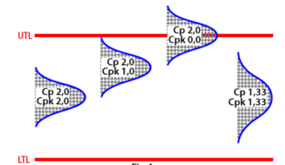

I am comparing sample (or "short term") capability vs overall (or "long term") capability for several processes for my data set (cannot share), using JMP. I find that for some processes, the overall Ppk is smaller than the lowest sample capability. To give an example with reference to the picture below, for some processes, JMP gives me a Ppk smaller than 1.33 which is lowest capability for a sample (blue distribution's below) for a given process. Intuitively, this does not make sense to me, but is this possible (mathematically?), if yes, under what circumstances? If not, where could I be going wrong with my JMP analysis?

@jthi I believe, each sample capability is calculated (JSL with example data here) using its own distribution i.e. the blue curves in each case, in the above example.

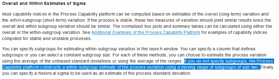

If I remember correctly STIPS has good lesson about rational subgrouping https://www.jmp.com/en_fi/online-statistics-course/quality-methods.html .
Also
https://www.jmp.com/support/help/en/18.0/index.shtml#page/jmp/overview-of-the-process-capability-pla...

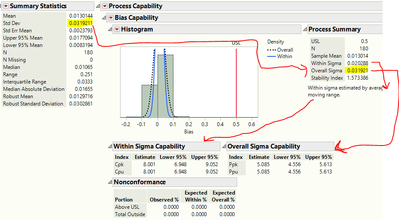

Ppk value based on overall standard deviation of the data (same with std. deviation that you see in Distribution platform).
Cpk value varies depends on "estimated sigma" method based on subgroup sample size.
There's no way your process improvement can change the d2 constant of the subgroup sample size in Cpk calculation.
I think in JMP, the default of "estimated sigma" for Cpk is "average moving-range".
You can see the "within sigma" notes.

Just to reiterate, that the Cpk discussed here is for a individual samples while the Ppk is for all the samples together i.e. overall capability. In my data, for some processes, I am getting overall capability (Ppk) lower than the lowest sample capability.
This discrepancy remains if I ask JMP to calculate Cpk (via within sigma capability summary) instead of Ppk or vice versa. The Cpk's are actually pretty close to the Ppk's so I do not think the discrepancy I am observing is stemming from the different ways of calculating sigma, rather my data.
I have used this script to check if I can reproduce the discrepancy with JMPs sample data but this does not show up for any process in the sample data.
