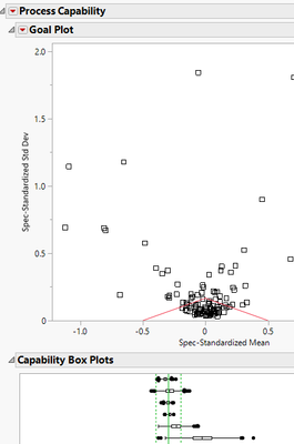

The output report generated by running a Process Capability analysis creates multiple, stacked, menu options to aid in interacting with the histogram and offers additional analysis options. When printing or saving the graph for reporting purposes these menu bars may not  be required and it would be helpful to suppress them from being displayed above the graph.  What is the best approach to remove all of triangle menu bars that are included in the Capability report view (Distribution Platform title, Process Capability title, Histogram title, etc), to create a cleaner graph for printing (ex. to pdf, etc).  I am aware of the Set and Show Title options in JSL, but have not been able to figure out if these are valid options to remove these titles .

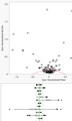

To remove the "menu bars" you're talking about, set the Outline Box title to "".  You can do all of them at once like this:
(Window( "Semiconductor Capability - Process Capability" ) << XPath( "//OutlineBox" )) << Set Title( "" );

Awesome!  That does exactly what I wanted.  Thank you!
